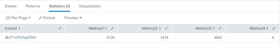

This search does the following:
  • Creates the test data (you can remove this for your actual data)
  • Extracts the method name and duration. These would be good Field Extractions to implement.
  • Prefixes all the method fields with "API_"
  • Creates fields using the {field} syntax - creating method fields with the duration as the value
  • Uses stats to create the table based on traceId
  • Renames all the API_* fields back to the method names
It results in:
