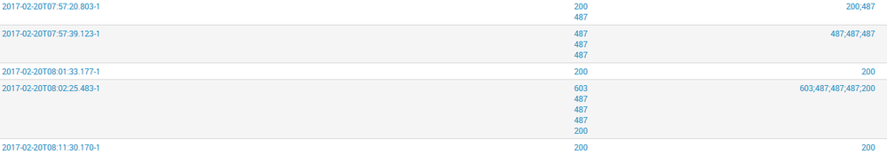

Hi guys can you tell me how i can count how many code 200 I have when i have do a mvjoin? I try with this search but it is not okay :
|stats list(ACR) as ACResponse by OCId
|eval X=mvjoin(ACResponse,";")
| search list(ACR)="*200*"
| stats count  list(ACR) by OCId

Depends on what you want the output to look like. This first part generates your test data, to the point of your first line:
| makeresults
| eval mydata="200,487 487,487,487,487 200 603,487,487,487,200 200"
| makemv mydata
| mvexpand mydata
| makemv delim="," mydata
| rename mydata as ACResponse
| streamstats count as OCId
| table _time OCId ACResponse
This part eliminates the records that do not include a 200 -
| search ACResponse=200
You could just do a stats count there, but since you seem to want to see the records, this part will collapse them and zip them together, then give you the count and list.
| eval ACResponse=mvjoin(ACResponse,";")
| eval OCId=mvzip(OCId,ACResponse,"::")
| stats count list(OCId) as OCId
Resulting in this output
count  OCId
  4     1::200;487
        3::200
        4::603;487;487;487;200
        5::200
