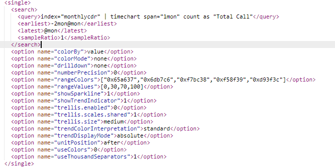

I can not figure out how to color the trend instead of the value. This is my search:
I found a documentation about it on splunk but it doesn't show how to use it or what command I should use. I look around and try option like colorvalue, rangemap, .... but have no result. This is the example i saw on splunk documentation site:
I want the big number to be black and the trendline along with the number below it to be a different color depend on the number. Did I do anything wrong here? Thanks

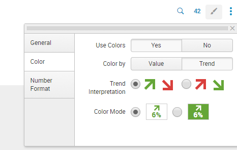

@tamduong16, you can change these settings from UI Edit by setting the visualization Format.
Following are the settings you need based on behavior described in your query through UI in Edit mode:
Following are the Simple XML chart configuration required for the same:
    <option name="colorBy">trend</option>
    <option name="colorMode">none</option>
    <option name="trendColorInterpretation">standard</option>
    <option name="trendDisplayMode">absolute</option>
    <option name="useColors">1</option>
Refer to Splunk Documentation on configuring Single Value visualization through Simple XML: https://docs.splunk.com/Documentation/Splunk/latest/Viz/PanelreferenceforSimplifiedXML#single_value
