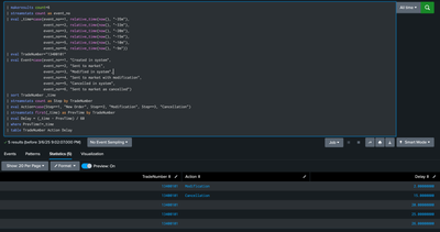

kiran_panchavat
Champion
@DPOIRE
Simulates trade events using makeresults, assigns timestamps, and labels each step (New Order, Modification, Cancellation). Uses streamstats to track event sequence, capture previous timestamps, and calculate time delay for each step.
Did this help? If yes, please consider giving kudos, marking it as the solution, or commenting for clarification — your feedback keeps the community going!
