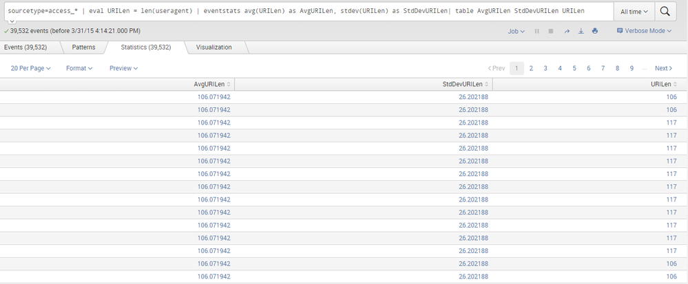

If i understand your problems, you want to return events where URILen > AvgURILen+(3*StdDevURILen) , this can be possible but, in your case, when i run sourcetype=access_* | eval URILen = len(useragent) | eventstats avg(URILen) as AvgURILen, stdev(URILen) as StdDevURILen| where URILen > AvgURILen+(3*StdDevURILen)| table AvgURILen StdDevURILen| table AvgURILen StdDevURILen ,
i get results not found . This explain that in the first part of query, that is sourcetype=access_* | eval URILen = len(useragent) | eventstats avg(URILen) as AvgURILen, stdev(URILen) as StdDevURILen| table AvgURILen StdDevURILen URILen
which displays like follow, there is no values of URILen where we can have URILen > AvgURILen+(3*StdDevURILen). Thus, can't get results.
