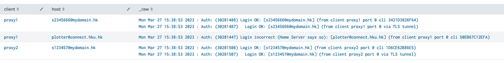

I have uploaded your data to my lab and then extracted what I think are the host and client fields (correct me if I'm wrong please). Then I did the transaction as per the below:
index=foo source=example
| rex "\[(?<host>[^\]]+).+client (?<client>\w+)"
| transaction client, host maxevents=2 maxpause=2 startswith="cli" endswith=eval(match(_raw, "(says|TLS)"))
| table client, host, _raw
And this is what I see as output, which looks OK to me based on the client and host:
If I remove the endswith from transaction this is what I get instead:
Which is very similar but not exactly the same. This is because you are forcing it to start with cli and then your maxevents are 2, meaning it's going to pick the next client/host combination matching the starting one. Whereas with the endswith you are forcing it to match says or TLS.
In any case, your event containing "says" won't match any other event in the list as the host (assumning I did the extraction correctly) is [email protected].
