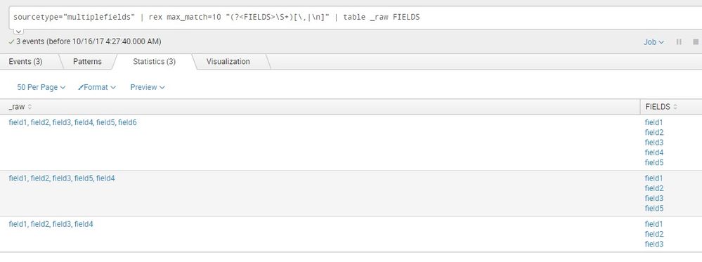

inventsekar
Please check -
sourcetype="multiplefields" | rex max_match=0 "(?<FIELDS>\S+)[\,|\n]" | table _raw FIELDS
you just want to pull all fields and make a table like this photo or some other operations you want to do, please clarify -
(PS- on the photo, one or two fields are not picked up, that is due to my sample file.)
