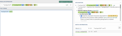

Hello,
I have some issues with Field Extraction, since there are some inconsistences in the structure of its field values. If we look at the following 2 sample events:  Amt, outputCd, and returnCd are null in one event and have some values for other event, and also values are within " " . I used following extraction codes which work fine (separately) with null and Values. But we can only use one extraction code to extract field values from the same field. Are there any ways I can write One field extraction code that will satisfy both conditions? Thank you so much, any help will be highly appreciated:
Field Extraction Code:
outputCd":(?P<outputCd>\w*)  [work with null]
Amt":"(?P<Amt>\w*)                      [work with values]
Sample Events
"timeStamp":"2021-12-09 08:55:30 EST","appName":"DEV","userType":"DBA","caseStatCd":null,"Amt":"100","errorMsg":null,"eventId":"VIEW_LIST_RESPONSE","eventType":"PENDING","fileSourceCd":null, "mftCd":null,"outputCd":null,"planNum":null,"reasonCd":null,"returnCd":null,"sessionId":"acMgt/dev” , "Period":”2021”, userId":"28f526d4-3464-4766-DBA "
"timeStamp":"2021-12-09 08:55:32 EST","appName":"SYS","userType":"ADM","caseStatCd":null,"Amt":null,"errorMsg":null,"eventId":"VIEW_LIST","eventType":"PENDING","fileSourceCd":”09”, "mftCd":null,"outputCd":"09","planNum":null,"reasonCd":null,"returnCd":”01”,"sessionId":"acMgt/dev” , "Period":null, userId":"28f526d4-3464-4766-ADM"

Hello,
Thank you so much again....just had to do a little tweak of your code "outputCd":\"?(?P<outputCd>\"?\w*) and working as expected. Thank you, appreciated!
ITWhisperer
Allow for optional double quotes
| rex "outputCd\":(?P<outputCd>\"?\w*\"?)"

Hello,
Thank you so much, appreciated. Yes,  your "outputCd\":(?P<outputCd>\"?\w*\"?)" is working fine with "outputCd":"09",  but giving no output for "outputCd": null, thank you again!

PickleRick
Mind you that this will also allow for any string not surrounded by quotes, not just null. But that on its own might not be that big of a problem, but it will also not work in general with any quotes delimited string possibly containing escaped quotes.

And as to the pattern itself... well, it's a bit tricky because I can't find a way to consume the quotes but not return them in a match. So you could do something like
"field":(?<value>\w+|"(?:[^"]|\\")*")
but that would capture the value of the field with the quotes. I don't know of any way to get rid of them without any postprocessing. (OK, maybe the conditional features of PCRE could allow that but that's ridiculous to write).

Hello, thank you so much, appreciate it. However, facing 2 issues the output comes with " " please see below:
 and it doesn't work for "outputCd": ,    [when no values]

Thank you again. I tried it with w*, but it doesn't work with "outputCd":"09", and I also wanted to avoid " " (double quotation) from the output.
ITWhisperer
| makeresults
| eval events=split("\"timeStamp\":\"2021-12-09 08:55:30 EST\",\"appName\":\"DEV\",\"userType\":\"DBA\",\"caseStatCd\":null,\"Amt\":\"100\",\"errorMsg\":null,\"eventId\":\"VIEW_LIST_RESPONSE\",\"eventType\":\"PENDING\",\"fileSourceCd\":null, \"mftCd\":null,\"outputCd\":null,\"planNum\":null,\"reasonCd\":null,\"returnCd\":null,\"sessionId\":\"acMgt/dev” , \"Period\":”2021”, userId\":\"28f526d4-3464-4766-DBA \"|\"timeStamp\":\"2021-12-09 08:55:32 EST\",\"appName\":\"SYS\",\"userType\":\"ADM\",\"caseStatCd\":null,\"Amt\":null,\"errorMsg\":null,\"eventId\":\"VIEW_LIST\",\"eventType\":\"PENDING\",\"fileSourceCd\":”09”, \"mftCd\":null,\"outputCd\":\"09\",\"planNum\":null,\"reasonCd\":null,\"returnCd\":”01”,\"sessionId\":\"acMgt/dev” , \"Period\":null, userId\":\"28f526d4-3464-4766-ADM\"|\"timeStamp\":\"2021-12-09 08:55:32 EST\",\"appName\":\"SYS\",\"userType\":\"ADM\",\"caseStatCd\":null,\"Amt\":null,\"errorMsg\":null,\"eventId\":\"VIEW_LIST\",\"eventType\":\"PENDING\",\"fileSourceCd\":”09”, \"mftCd\":null,\"outputCd\":,\"planNum\":null,\"reasonCd\":null,\"returnCd\":”01”,\"sessionId\":\"acMgt/dev” , \"Period\":null, userId\":\"28f526d4-3464-4766-ADM\"|\"timeStamp\":\"2021-12-09 08:55:32 EST\",\"appName\":\"SYS\",\"userType\":\"ADM\",\"caseStatCd\":null,\"Amt\":null,\"errorMsg\":null,\"eventId\":\"VIEW_LIST\",\"eventType\":\"PENDING\",\"fileSourceCd\":”09”, \"mftCd\":null,\"outputCd\": null,\"planNum\":null,\"reasonCd\":null,\"returnCd\":”01”,\"sessionId\":\"acMgt/dev” , \"Period\":null, userId\":\"28f526d4-3464-4766-ADM\"","|")
| mvexpand events
| rex field=events "eventType\": ?\"?(?P<eventType>\w*)\"?\,?.*outputCd\": ?\"?(?P<outputCd>\w*)\"?\,?"

Yes, working as expected 🙂, thank you so much, truly appreciated!!!
