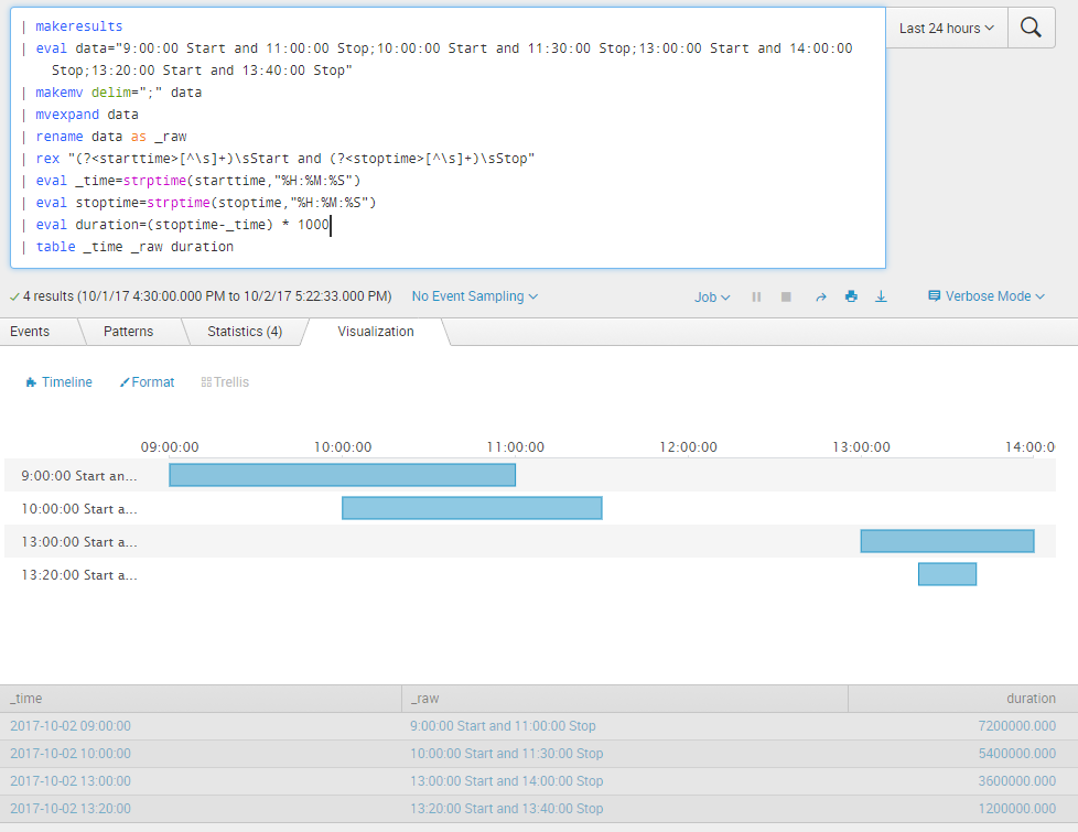

Based on the sample data you can try out the following run anywhere search. Commands till | rename data as _raw created dummy data as per the question. Splunk rex command extracts the starttime and endtime. If there is something in the data to uniquely identify event as well, then the same should be used. I have used _raw data itself as event since the information was not present.
Use strptime()function to convert HH:MM:SS to epoch time. Calculate duration as the difference between stoptime and starttime to get duration as seconds and then multiple by 1000 before feeding to Timeline custom visualization
| makeresults
| eval data="9:00:00 Start and 11:00:00 Stop;10:00:00 Start and 11:30:00 Stop;13:00:00 Start and 14:00:00 Stop;13:20:00 Start and 13:40:00 Stop"
| makemv delim=";" data
| mvexpand data
| rename data as _raw
| rex "(?<starttime>[^\s]+)\sStart and (?<stoptime>[^\s]+)\sStop"
| eval starttime=strptime(starttime,"%H:%M:%S")
| eval stoptime=strptime(stoptime,"%H:%M:%S")
| eval duration=(stoptime-starttime) * 1000
| table starttime _raw duration
PS: While the query works for start and stop time within a single day, it would not work it stop time spanned to the next day or the day after. It is better to log date-time to handle such scenarios rather than handling in the query.
