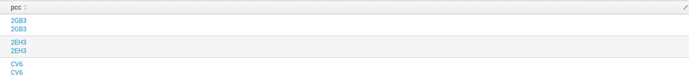

Rex is doing a great job and extracts the value the way I want, but when I try to view results in a table, I get two values in one row, like that (these results are for three log files):
Even if I use "dedup pcc" before "table pcc", I still get those duplicate value rows. In logs there is another field called "msg" (path = info.msg) that has the same string as "message", so that can be the cause of this duplication, but my query says that the field should be "info.message", not "info.msg".

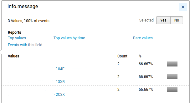

Below is a screenshot of the "info.message" field. I erased confidential info, but that is not important, because I am trying to extract the visible 4 symbol code. As you can see, there are 3 unique records but each of them has a count of 2. Also, there is another field that has a path "info.msg" and contains the exact same information as "info.message".
DalJeanis, do you know maybe whether rex'es field treats its input not as a path but rather a kind of alias or something? If yes, then how can I know that "info.message" is an alias?

Check to see if info.message is an alias for another field as well as an extracted field in its own right.
That is, do a search that returns one of the records in question, and look at the record's fields to see if info.message has two values.
