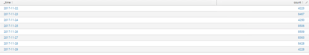

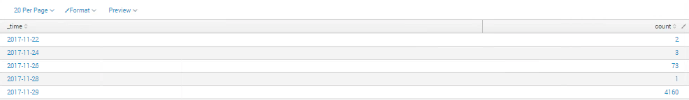

I want to count distinct machine names only once for each day for the last 7 days. The machine name is signified in the logs as 'Name0'
   index=<index> source=<source>
       | dedup Name0 |eval machine=lower(Name0)
    | search
        [ search `ProductionWorkstations`
        | table machine]
    | bucket _time span=day | stats count by _time
I have uploaded two screenshots which use 'uniq Name0' and 'dedup Name0' in the search but the uniq search doesn't show distinct machines as the typical count usingdedup values within a 24 hour period is around the '4100' mark so the dedup search below is only counting distinct machines across 7 days.
