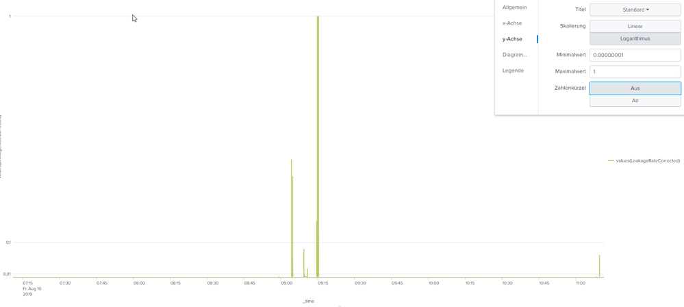

Hi everyone,
I have continuous data from a leakage test station with values as low as 1e-8 and spikes up to 1e-2 mbar*l/s (in the image its way higher but this is very rare).
Is there a way to display them over this span correctly in a standard timechart?
I already tried to set min or max for y axis and converted the y axis to logarithmic.
The logarithmic scale seems to display only 1, 0.1, 0.01 and not smaller or at least gives the smaller numbers not enough 'room' to display (from 1 to 0.1 is 90% of the timechart area, from 0.1 to 0.01 is 8% and for the smaller values just 2 % of the area).

I had trouble with this as well.  Log scale charts in splunk appear to be broken for non-positive powers of 10:
  1. Like the above example, when my data is from 0-1 the gridlines display for powers of 10 but the chart is still linear scale (0-0.01 is 1% of the scale, 0.01-0.1 is 9% of the scale, 0.1-1.0 is 90% of the scale).  For a true log scale, 0.01 to 0.1 would have the same vertical scale as 0.1 to 1.0, 1.0-10.0, 10.0.100.0, 0.001 to 0.01, etc.)
  2. When I have data from 0.001-100, the data is charted log scale but the divisions are 0-10, 10-100, 100-1000).  These are equally spaced but I would expect to see gridlines for 1.0, 0.1, 0.01.  The result is that data from 1-100 is easy to visualize but data from 0.001-1.0 is compressed at the bottom of the chart
My workaround is to chart log(value) on a linear scale, but this is not easy to consume for most folks.
haph
In the image there is no "0" value. They are actually something like 1e-8
