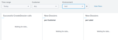

As mentioned I already have dashboards in place with the needed filters:
Trying to think this through - can I add a "custom field" (type string) which would be used as an additional filter (in the screenshot)?
This way I could achieve the same thing you mentioned (dashboard with selectors) + the custom field & it would solve the issue.
BTW Thank you for your time & effort @richgalloway , I really appreciate it.
richgalloway
Yes, that should work.
Filomenka
Thank you rich, you are a lifesaver! 🙂 Works like a charm...
