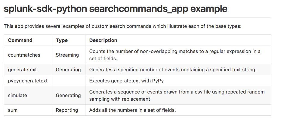

There are some great examples in the Python SDK:
https://github.com/splunk/splunk-sdk-python/tree/master/examples/searchcommands_app
At time of writing:
├── bin
│   ├── splunklib
│   │   └── searchcommands ....... splunklib.searchcommands module
│   ├── countmatches.py .......... CountMatchesCommand implementation
│   ├── generatetext.py .......... GenerateTextCommand implementation
│   ├── pypygeneratetext.py ...... Executes generatetext.py with PyPy
│   ├── simulate.py .............. SimulateCommand implementation
│   ├── sum.py ................... SumCommand implementation
├── default
│   ├── data
│   │   └── ui
│   │       └── nav
│   │           └── default.xml ..
│   ├── app.conf ................. Used by Splunk to maintain app state [1]
│   ├── commands.conf ............ Search command configuration [2]
│   ├── logging.conf ............. Python logging[3] configuration in ConfigParser[4] format
│   └── searchbnf.conf ........... Search assistant configuration [5]
└── metadata
    └── local.meta ............... Permits the search assistant to use searchbnf.conf[6]
