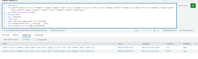

Below is a screenshot of how this might work (based on a sample data gen)
This is the full SPL for the example
| makeresults
| eval json="[{\"data\":{\"fruit\":{\"common\":{\"type\":\"apple\",\"foo\":\"bar1\"},\"apple\":{\"color\":\"red\",\"size\":\"medium\",\"smell\":\"sweet\"}}}},{\"data\":{\"fruit\":{\"common\":{\"type\":\"pear\",\"foo\":\"bar2\"},\"pear\":{\"color\":\"green\",\"size\":\"medium\",\"taste\":\"sweet\"}}}}]"
| eval events=json_array_to_mv(json)
| mvexpand events
| eval _raw=events
| fields _raw
| spath "data.fruit.common.type" output=fruitType
| eval colorPath="data.fruit." . fruitType . ".color"
| eval fruitColor=json_extract(_raw,colorPath)
Please let me know how you get on and consider adding karma to this or any other answer if it has helped.
Regards
Will
