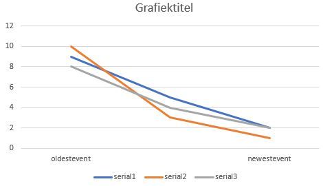

case:
Logged events with differentiating fuellevel and the corresponding serial
Desired outcome:
So a graph with multiple lines, a line is based on a serialnumbers from the events, with vertically the value of a field within that same event.
Please help!

Thanks! That indeed gives me the max fuellevel per day! What is the option if I want to see it per event? Because some serials will have like 10 events per day and others will just have a few or even none on a day.
