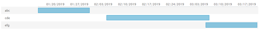

@rpradeep on a different note try the Splunk Timeline Custom Visualization
Following is a run anywhere query which you can try.
| makeresults
| eval data="abc 2019-01-15 2019-01-20;cde 2019-02-04 2019-02-14;efg 2019-03-05 2019-03-10;"
| makemv data delim=";"
| mvexpand data
| makemv data delim=" "
| eval "employee"=mvindex(data,0), start_date=mvindex(data,1), end_date=mvindex(data,2)
| eval _time = strptime(start_date, "%Y-%m-%d")
| eval end_time = strptime(end_date, "%Y-%m-%d")
| eval duration = (end_time - _time) * 1000
| stats count by _time, duration, employee
| table _time employee duration

Thanks @niketnilay , this looks amazing too.
Although, I am not able to understand the logic behind 1000(random()%5). Without this I am not getting exact results.
niketn
Legend
@rpradeep, I have corrected the query. I had taken it from run anywhere example which comes with the app. Please refer to the updated query above.
rpradeep
Perfect now.
