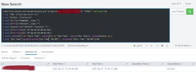

@kamlesh_vaghela
That search returns no results in my environment
Here is the (partially) working search

I have tried adding the eval to my original search but no results found
kamlesh_vaghela
@timrich66  Can you please check time format of start time and end Time ??
timrich66
Communicator
Hi @kamlesh_vaghela
Both Start and End Time use _time which is in the format %d/%m/%Y %H:%M:%S e.g. 23/06/2021 09:05:05
The strftime format to return to human readable is - "%Y-%m-%d %H:%M:%S.%Q"
Is that what you need?
