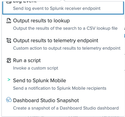

At the moment, I have an alert configured to send an email when the trigger condition is met. However, I would like that email to include a PDF attachment with a snapshot of the Dashboard Studio dashboard.
I have also noticed a new Alert Action called Dashboard Studio Snapshot. However, I have tried searching for information about how it works, but I haven’t found any documentation or available examples.
Screenshot 2025-10-16 at 9.24.14 PM.pngScreenshot 2025-10-16 at 9.24.14 PM.png

I also wasnt able to find a scrap of documentation about this feature, however I think Ive worked it out based on the script (etc/apps/splunk-dashboard-studio/bin/studio_snapshot.py) that the action runs.
The action triggers a dashboard snapshot for the same ID as the name of the saved search, within the same app with the same owner.
For example - if you have a Published Dashboard called 'Test Dashboard' (whose id/slug is 'test_dashboard' then you will need to create an alert called 'test_dashboard' with the 'Dashboard Studio Snapshot' action.
When the alert triggers and there is >0 events it will call the action which will trigger a new snapshot of the published dashboard.
