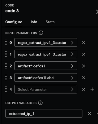

I am new to Splunk SOAR and I have a custom python code block that I am creating and exporting a variable to a Splunk action block.
The variable in the custom code block is set fine and with debug statements I can see it set correctly.  I then export that variable.
In the splunk action block , I import that variable but when I try to use it the value is set to "None".  When I import soar system variables, it works fine.
There are no error messages.  SOAR has the auto fill for the variables so not like I have a typo.
Screen shot below {0} is my customer code variable that gets set to none.
{1} is from the extract ip utility and that is set fine.

Ah there's your problem. You assign the variable "extracted_ip_1" which then works fine within the function, but in the following phantom.save_run_data function call, it does not actually dump the value of the "extracted_ip_1" variable into the output, but rather the "code_3__extracted_ip_1" variable, which is previously set to None.
You should change the phantom.save_run_data command to use the correct variable name in the value parameter:
phantom.save_run_data(key="code_3:extracted_ip_1", value=json.dumps(extracted_ip_1))
Or, if you want to constrain all custom code between the "custom code" comment blocks, you can change the variable name:
code_3__extracted_ip_1 = regex_extract_ipv4_3_data_extracted_ipv4[0]
Also you mentioned your data path on the input to the following block is "code_3:customer_function:extraced_ip_1", which has "customer_function" but it should have "custom_function". Not sure if this is just a typo in your post but if it exists also in your SOAR instance then it can also cause problems.

Did you defined as an output variable in the custom code block’s configuration?
Your variable likely not being exported due to this.

It seems that you are not using {0} in your query input.
Also can you post the sanitized code for the code block and the full entry for the data path of the 0 input?

Thank you for the responses.  I copy/pasted some of the SOAR info below and as for the questions:
  • I did define the output variable in the custom code block config
  • I am not using {0} in the sample block because it kept giving an error .  I was using {1} because that was grabbing the IP through a utility and that was working for me.
  • The variable from the custom code block (extracted_ip_1) worked fine within the code block but was not set outside of it.
  • code_3:customer_function:extraced_ip_1

Ah that all makes sense.  Thanks so much for the help.   Can't wait to try it.
Yep, that did the trick.  Thank you so much!  And yeah "customer" was just a typo on my part.
