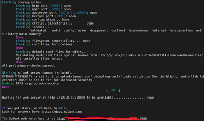

I am able to install the splunk 9.4.2 in our system and run the splunk start
but I cannot access the UI with the address:
http: {domain-name}:8000.

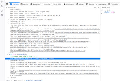

the web ui show nothing, and I inspect it,
"browser-not-supported"? I try multiple browser(Chrome, Edge, Firefox)
h2rr821
I fix it by reset the proxy setting.
I am able to access the web ui.
Thank you very much!!

As other already said there is probably firewall between your workstation and splunkd running on your RHEL7 box. It could be on RH or if there is any FW between network segments then those are possible candidates.
One way to try it is use ssh tunneling from your workstation to that box (if it's allowed on RH side). Or you could try it with curl on that box to test if it response or not.
Based on your screenshot it should be up and running.
