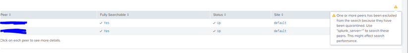

I've recently had to take an indexer offline while I worked on storage so I ended up putting it into quarantine  until things were resolved. Now that things are resolved, I can't seem the indexer is receive data but I still have the below error within the monitoring console:
"One or more peers has been excluded from the search because they have been quarantined. Use "splunk_server=*" to search these peers. This might affect search performance."
My cluster manager now sees both indexers (01 and 02) in this group but the there are still errors suggesting the 02 indexer is still quarantined. The indexer02 was the one quarantined which is now receiving data and shows up in the monitoring console but with  the above error
Any advice on how to unquarantine this indexer or resolve this message?

I had to remove the entries in the $SPLUNK_HOME/etc/system/local/distsearch.conf within the master server and restarted. I then went into the monitoring console -> Settings -> enabled the indexer -> corrected the roll to only-indexer -> applied changes. Now the monitoring console  looks good.
[distributedSearch]
disabled = 0
disabled_servers = https://<server01>:8089 <---- Removed this
quarantined_servers = https://<server01>:8089 <---- Removed this

Have you tried on settings -> distributed searches -> search peers? You could find those option there. One thing what you also could try is click node name and reauthenticate it. Then again unquarantine it.
r. Ismo
rewritex
Contributor
Thank you for the reply. This settings area was blank but I ended up having to manually adjust the distsearch.conf file within the master server to remove the server from quarantine.
