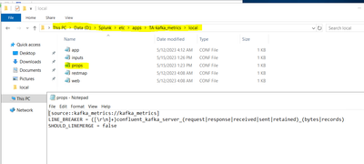

Hmm, not sure whats wrong with my setup, I have modified the props.conf as below and restarted the splunk service. Still its coming as a single event.

I wonder if the problem lies with the stanza name rather than the LINE_BREAKER setting.  If the name in a source::// stanza doesn't match the name of the data source then the settings will not be applied.
A source named "kafka_metrics://kafka_metrics" seems like a rather odd file name.  Are you sure that's the correct source name?  How are you obtaining the name?

yes,  source="kafka_metrics://kafka_metrics" as you can see here below;
richgalloway
Is that the *raw* source name, before any Splunk transforms?
Can you change the stanza to a sourcetype one, at least to confirm the regex is correct?
roopeshetty
our sourcetype=kafka_metrics, now i have modified the props.conf as below, but still the same issue. Do i need to change anything in transforms.conf as well?
richgalloway
The screenshot says "props".  Is that the actual file name?  It should be props.conf.
It's difficult to determine if changes need to be made to transforms.conf without seeing the file, but since props.conf does not reference any transforms I'd say "no".
I'm still waiting for an answer to this earlier question: Are you looking at data that was onboarded after the change (and restart)?
How is the script(?) that is making the API calls tagging the data as sourcetype=kafka_metrics?  How is the data being sent to Splunk?
