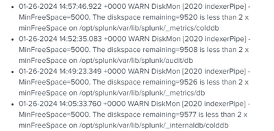

Hello everyone,
I'm currently trying to optimize Splunk with disk space and index.
I read about :
  • Changing the parameter "Pause indexing if free disk space (in MB) falls below"
  • Never modify the indexes.conf parameters
  • And some others posts of the community
But I'm not quite sure about the solution for my problems :
The coldToFrozenDir/Script parameters are empty.
Kind regards,
Tybe

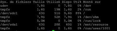

When I run the command :
sudo du -sh /*
So, do I need to reduce the retention time of maybe something is using more space than it should be ?

1. This is not a big server.
2. You seem to have much data in /var (almost as much as your whole Splunk installation). Typically for a Splunk server /var would only contain last few days/weeks of logs and probably some cache from the package manager.  This is up to you to diagnose what is eating up your space there.
