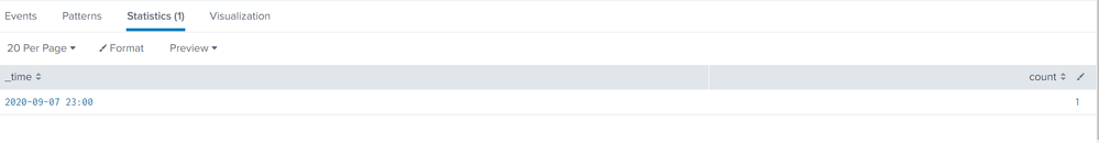

2020-09-07 23:59:46,772 tid:638rdchdfe7vhs INFO  [org.class.MediaCredentialValidator] in processPasswordCredential VERIFIED user=test@gmail.com found and success
below is the query joins based id found in s1.txt and s2.txt , there is only one match
(source="s2.txt" host="abcd" sourcetype="test1" "In processPasswordCredential" "found and success") OR (source="s1.txt" event=AUTHN_ATTEMPT clientId=web status=inprogress host="abcd" sourcetype="test1")
| rex "tid:(?<id1>[^\s]+)"
| rex "\"id:(?<id2>[^\"]+)"
| eval id=coalesce(id1,id2)
| eventstats dc(source) as dc_source by id
| where dc_source=2
| stats latest(_time) as _time by id
| timechart span=1h count
 you will get results like below:
