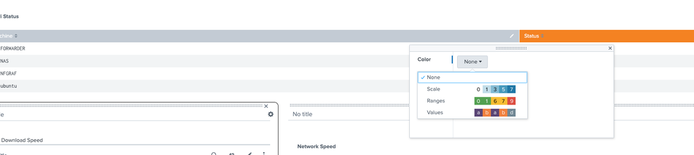

You can edit the table in the UI editor and select the column header for some coloration options.
They are a little on the limited side but as far as I know, thats the best option there is. When you have selected a coloration, I would check the xml in the back to see whether there's further control within the table for extra params.
The docs here may also be of use: https://docs.splunk.com/Documentation/Splunk/latest/Viz/ChartConfigurationReference
