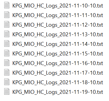

I want to configure CRC Salt but I am quite not sure how write it on inputs.conf.
The directory on splunk is like this: /home/csaops/csasec/NFV/KPG_MIO_HC_Logs_2021-11-10-10.txt
How do I configure this configuration?

Hi @Azwaliyana,
crcSal is useful to read again a file that with a normal input configuration was already read.
As you can read at https://docs.splunk.com/Documentation/Splunk/8.2.3/Admin/Inputsconf#MONITOR:
crcSalt = <string>
* Use this setting to force the input to consume files that have matching CRCs
  (cyclic redundancy checks).
    * By default, the input only performs CRC checks against the first 256
      bytes of a file. This behavior prevents the input from indexing the same
      file twice, even though you might have renamed it, as with rolling log
      files, for example. Because the CRC is based on only the first
      few lines of the file, it is possible for legitimately different files
      to have matching CRCs, particularly if they have identical headers.
* If set, <string> is added to the CRC.
* If set to the literal string "<SOURCE>" (including the angle brackets), the
  full directory path to the source file is added to the CRC. This ensures
  that each file being monitored has a unique CRC. When 'crcSalt' is invoked,
  it is usually set to <SOURCE>.
* Be cautious about using this setting with rolling log files; it could lead
  to the log file being re-indexed after it has rolled.
* In many situations, 'initCrcLength' can be used to achieve the same goals.
* Default: empty string
 and at https://docs.splunk.com/Documentation/Splunk/8.2.3/Data/Howlogfilerotationishandled#How_the_Splunk_p...
you have to use
crcSal = <SOURCE>
to add also the complete file path name to the check.
Note that you have to insert in your inputs.conf the full option as you can see, it isn't to configure.
Ciao.
