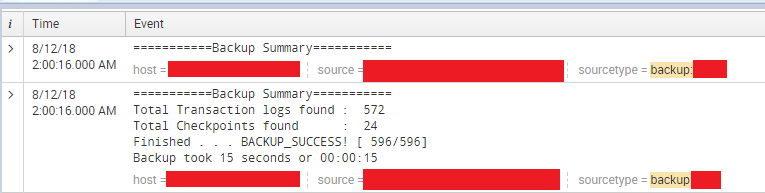

Hi ,
I am having trouble right now on why does the splunk log is not complete/cut , in the past few months logs are coming consistently complete.
but now it is cut shows only the header and no information.
it came from a server that monitor the logs,
Can somebody tell me why this happens ?
what to investigate ?
Also what is the solution for this problem?
-thanks in advance

1) here is my configuratoin file :
Inputs:
[monitor:///var/log/backup]
disabled = 0
sourcetype = backup:mtx
there are no props and transforms set on the whole process.
Server(log)-universal forwarder > indexer > search head
2)Are the logs getting truncated by any chance?
- The logs are being cut off in that specific part,
there are chances that it would gave as a whole, but most of the time it is missing parts after the
"============Backup Summary============"
45% of the log it sent are being cut.
Still can't figure this out.
