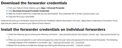

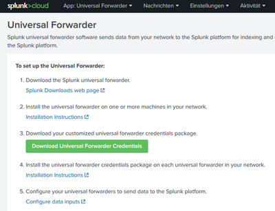

Hello, i want to install the universal installer on a windows 2016 server.  I proceed according to these instructions:
In point 3, reference is made to the installation instructions for Linux.
I downloaded the splunkclouduf.spl
This is the point about Linux or not? Install the following app by entering the following command: / opt / splunkforwarder / bin / splunk install app /tmp/splunkclouduf.spl.
How do I install the credentials for on a Windows machine?
