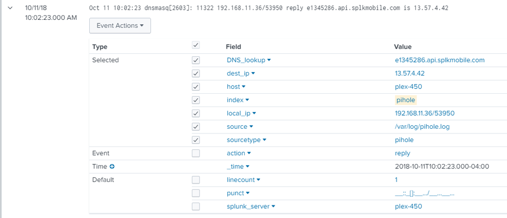

I've recently installed optiv threat intel on my splunk indexer on my home network - trying to make it use logs from my DNS (Pihole).
I currently just get this: alt text
Here's an example of a log entry in how I have the fields defined.
I'm trying to ascertain if I've set it up incorrectly, or if I just don't have any malicious activity on my network and "no news is good news."
I'm relatively new to splunk - but I can run searches for top and rare for the dest_ip field - so I at least think I have the fields setup correctly. Any light someone could cast on this would be much appreciated.
