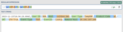

First glance it looks like this the regex you provided is looking for double quote to help find the pattern and the sample event don't seem to have any.
I think you may have better luck using a regex closer to
REGEX = \s+([^:]+?):\s+([^,]+)
I havent tested locally but on regex 101 it looks like it matches pretty well

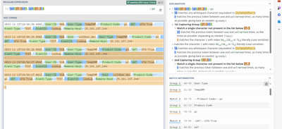

Hello @dtburrows3,
Thank you so much for your quick response, truly appreciate it. I am getting this:
