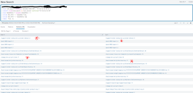

Your query does not give me the required output.
If URL X is associated to 1, Y associated to 2 and Z associated to 3 and each are in the "from column", the respective "to" column is Y to 2,  Z to 3, ...... and blank at the very end as the last URL in "from" to connected to no other URL.
Your query just increases the final number, without changing the URL associated with that number. So, the above example would make the "to" column simply X is associated to 2, Y associated to 3 and Z associated to 4.
This is further shown on the output I got in splunk:
I need to maintain the relationship with the URL and the final number as I increase each value by 1 to create the "to" field and have the last value blank .
