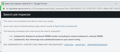

jonaclough
Additional info: you  can see the limit being hit from the job inspector:
