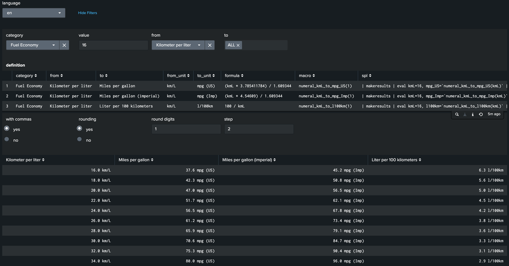

A bit useful dashboard where you can find macros and learn how to use them
It can also be used as a quick reference table for unit conversions.
Conversion of unitsConversion of units
Drill down (click on the table) to open a sample SPL in a search.
Usage exampleUsage example
Legend of macro usage
| eval FieldAfterConversion = `numeral_UnitBefore_to_UnitAfter(FieldBeforeConversion)`

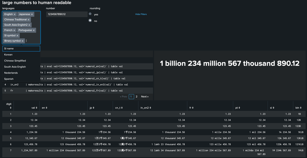

There is also a dashboard for checking how to use macros that display large numbers with expression such as "150 million", and macros that convert the number of bytes into human easy readable units.
large numbers to human readablelarge numbers to human readable
