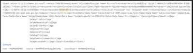

We are using Splunk Universal Forwarder (UF) to forward logs from a Windows server to a Splunk Heavy Forwarder (HF). However, when the Splunk HF receives logs of a specific type as multiline, an issue arises. In this case, when attempting to forward these logs from the Splunk HF to a syslog server (a Linux server with rsyslog configuration), the logs are getting truncated. How can we address and resolve this issue?

The screenshot shows an untruncated event.  What makes you believe the logs are getting truncated?  Please show a sanitized sample truncated event.

please check the truncated event from syslog server
We are attempting to send logs to both the Splunk indexer and the syslog server because different teams handle distinct log types. My team manages the system security logs specifically for SOC team monitoring.
