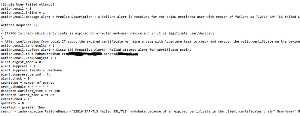

hi @VatsalJagani
i have checked the savedsearches.conf for single user attempt and it is as below and everything is normal in it and i didn't find any abnormality in it. please find the screenshot in it and please tell me if you find any abnormality.
thanks in advance.....
VatsalJagani
Which location did you find this file?
Other than that I don't see any issues, unless Splunk is behaving something differently.
