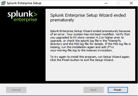

I have just updated my indexer cluster composed of 4 windows 2022 servers, to the new version of Splunk 9.4.0.
As always I follow the update procedure, but this time one of my 4 servers refuses to update, it makes a rollback each time.

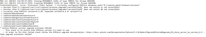

Elbald97_0-1734536900050.pngI check the installations failed logs and noticed that the KVstrore was failing to update!
Can anyone help me fix this problem?

In 9.4.0 KV store has been upgarded from 4.2 to 7.x, as this is a major change for KV store
as per your deatils upgrade is not working in Indexers.
try following link for preupgrade checks for  KV store upgarde
https://docs.splunk.com/Documentation/Splunk/9.4.0/Admin/MigrateKVstore#Prerequisites
if these are indexers , KV store is not needed on them. you can disable using following on  indexers  server.conf
[kvstore]
disabled=true
to aviod kv store upgarde aslong with Splunk 9.4.0 upgarde
kindly set kvstoreUpgradeOnStartupEnabled=false
post splunk upgarde you can upgarde KV store
if these are searchheads then do not disable KV store
kindly refer to following documentation for mor details
https://docs.splunk.com/Documentation/Splunk/9.4.0/Installation/AboutupgradingREADTHISFIRST#Key_poin...
Elbald97
I didn't know you had to disable kvstore on indexers.
It works, I was able to update my server.
Thanks.
