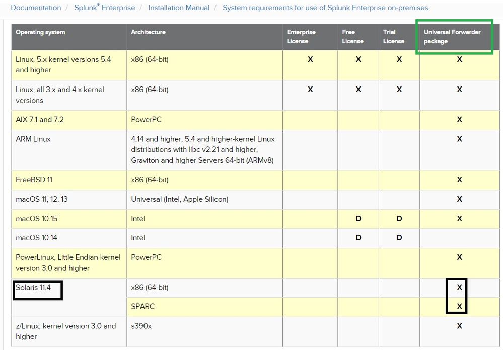

Hi @DANITO115 ...on Solaris only Universal Forwarder can be installed and logs can "collected" from the Solaris.
Indexer / Search Head, HF, LM, DS, etc can not be installed.
image is from
https://docs.splunk.com/Documentation/Splunk/9.1.1/Installation/Systemrequirements
