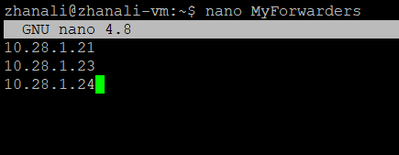

MyForwarders and MyForwarders_U are simple text files for storing IP addresses of target machines:
