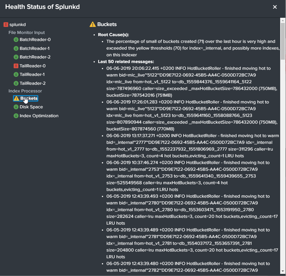

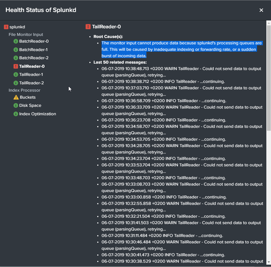

Hi, we have upgraded to 7.2.6 and we are getting errors all the time now. Today we have used 3 GB of our licenses- so not much, however, I have issues below (Images).
I have 3 questions:
1) We have a single install (1 search head and 1 indexer) and thinking of moving to 5 indexers and 1 search head, will this help this issue?
2) What happens when the tail reader is full, who suffers what are the impacts, how can I help this?
3) What happens when buckets are full, who suffers what are the impacts, how can I help this?

I have just adjusted the parameter maxQueueSize in the outputs.conf file to a grater value in the HeavyForwarder, default is 500Kb. That have solved the issue.
impacts, how can i help this?
You are experiencing issues that might be due to timestamping problems. Make sure your data getting indexed has the correct settings applied and _time gets extracted correctly. This thread on answers is also a good starting point for troubleshooting.
can i help this?
A high number of buckets created should be avoided. Because of how Splunk works, it will impact your performance when many buckets have to be opened and kept open (due to the mentioned timestamping problems for example).

Some of our data does not have a time stamps, i am not sure if i can do anything about that as i needed it. I know the specific source type its GC data with no timestamp.
