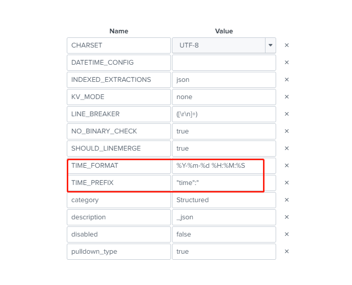

first a log sample:
{"offset":44469279,"messages":"<190>Mar 5 2020 06:40:55 WH-USG-MAIN %%01POLICY/6/POLICYPERMIT(l):vsys=public, protocol=6, source-ip=172.16.174.2, source-port=9054, destination-ip=10.251.30.14, destination-port=443, time=2020/3/5 14:40:55, source-zone=dmz, destination-zone=trust, rule-name=GRE.\u0000","fields":{"service":"network-log"},"client_ip":"10.251.0.254","time":"2020-03-05 14:41:20","prospector":{"type":"log"},"source":"/data/network/logs/network/buffer.b5a015d0cd6da0203206d47dc21494bdb.log","@timestamp":"2020-03-05T06:41:20.000Z","beat":{"version":"6.2.4","hostname":"network-log-input","name":"network-log-input"}}
i want to extract ,"time":"2020-03-05 14:41:20" this part for my indexed time _time field
you can see my sourcetype config like blow:
but i can't get this time , still use the server local time for the _time field.

thanks everyone , all the configuration is correct, at last ,i restart splunk service, now it is extract ok now .

JSON is in valid format. You don't need to provide TIME_PREFIX and TIME_FORMAT. FIeld time is already extracted so you just need provide TIMESTAMP_FIELDS = time. This will set _time to time values.

yes , i had try this TIME_PREFIX = \"time\":\" but still can't work.

Hi @meg_li,
TIME_PREFIX accept a regex and " is a special char so you should try with this regex:
