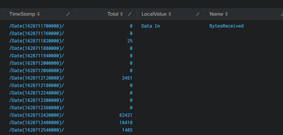

I have data that looks like
so the above is like 1 row and then there are multiple  rows with the same type of list of entries for timestamp and total
now I want to turn each row into a line on a line chart where the x-axis is the timestamp and the y-axis is the "Total". sort of like overlapping line charts based on all the rows.

Hello, So i have tried that the issue is tho and then i get a table that looks like this
so then i apply same thing to the Total columns and i get a bunch of duplicate rows, is there a way to delete all duplicate rows at that point?
