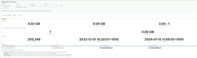

Hi @jbates58 Yes, at times the retention policy may give difficult times.
in DMC Server, Pls check this...  Settings > Monitoring Console > Indexing > Indexes and Volumes > Index Detail: Instance
EDIT - Pls check the docs at https://docs.splunk.com/Documentation/Splu nk/9.1.2/Admin/Indexesconf
one thing to remember - frozenTimePeriodInSecs vs maxTotalDataSizeMB - can give confusion as well (i remember whichever comes first will work and take precedence over the other)
jbates58
Observer
Here is the contents of that page. I have redacted out a little bit of info relating to the environment.
