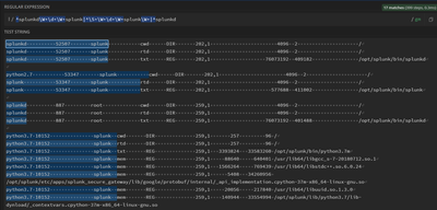

wgawhh5hbnht
Communicator
Yup, here's all three of them together:
richgalloway
It's interesting that line 2 looks like it should match, but isn't flagged as a match.
