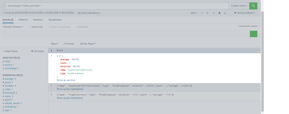

Hi @agoyal,
I have tried with this json and able to make it.
[{"name": "TraderCurrency","type": "RiskBreakdown","duration": 1173,"count": 1,"average": 1173.0}, {"name": "CounterpartyPreSettlement","type": "RiskBreakdown","duration": 312934,"count": 1,"average": 312934.0}, {"name": "CounterpartyNotional","type": "RiskBreakdown","duration": 406789,"count": 1,"average": 406789.0}]
Can you please try this?
props.conf
[reset_profiler]
NO_BINARY_CHECK=true
BREAK_ONLY_BEFORE=([\{])
MUST_BREAK_AFTER=([\},])
SEDCMD-remove_bracket=s/\[|\]//g
LINE_BREAKER=(,\s)
KV_MODE=json
You can extract events like below:
