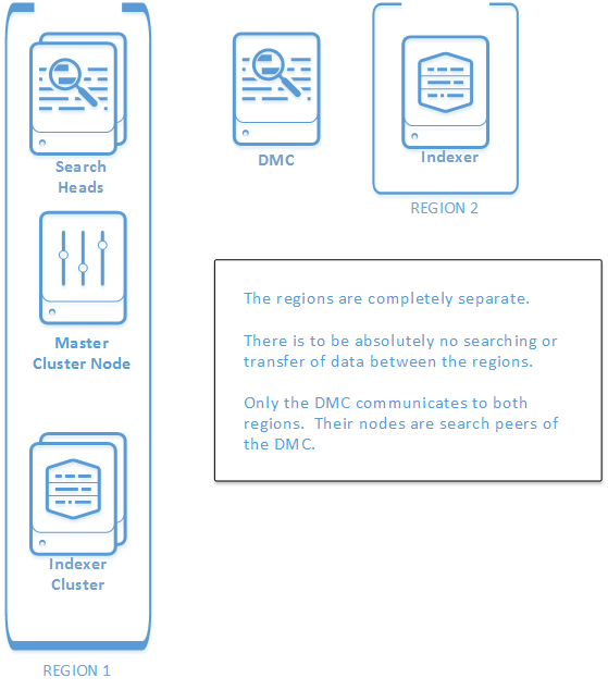

I have a single Distributed Management Console which I have monitoring separated regional indexers like so....
I had everything from Region 1 registered in the DMC first and then I registered the Region 2 standalone indexer and now I see these messages in remote_searches.log on each of my Region 2 clustered indexers.....
INFO StreamedSearch - Streamed search connection terminated: search_id=remote_REGION_1_SEARCHHEAD_123456789, server=REGION_1_SEARCHHEAD, active_searches=1, elapsedTime=0.641, search='litsearch index=_internal "Unable to distribute to peer named REGION_2_INDEXER" | fields keepcolorder=t "*" "_bkt" "_cd" "_si" "host" "index" "linecount" "source" "sourcetype" "splunk_server" | remotetl nb=300 et=1455733920.000000 lt=1455737578.000000 remove=true max_count=1000 max_prefetch=100', savedsearch_name=""
This also occurs in splunkd,log on the DMC.....
WARN DistributedPeerManager - Unable to distribute to peer named REGION_2_INDEXER at uri https://REGION_2_INDEXER :8089 because replication was unsuccessful. replicationStatus Failed failure info: failed_because_BUNDLE_DATA_TRANSMIT_FAILURE
I don't understand why the DMC is trying to push a bundle to the Region 2 indexer.
