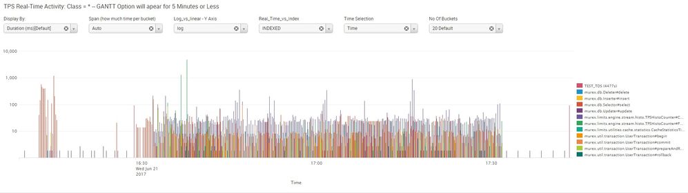

I have created one user = PARIS (CET).
I can log in with this user from PARIS(Via Citrix) Or On my desktop in Dublin (-1H Behind Paris).
I am displaying epoc _time.
From Both DUBLIN and PARIS i see PARIS time, In a timechart graph and this works well.
