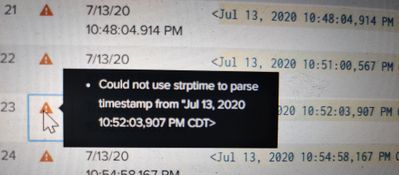

My logs are that kind :
<July 13, 2020 10:55:02,572 PM CDT>
So i used TIME_FORMAT=%b %d, %Y %H:%M:%S, %3N%p%z
But it is not parsing and showing me error that " could not use strptime to parse timestamp from "july 13, 2020 10:52:03,907 PM CDT>
Please let me know how to solve this issue.

@richgalloway  Above is the error. Please help me how to fix this one.
richgalloway
I got the time zone decoder wrong. Try my updated reply.

@richgalloway Still showing the same error. Please let me know to fix this.

@faizancool85  The same error which i pasted earlier.
richgalloway
A screen shot is not sample data. Sample data is something we can paste into our own Splunk instances to test possible solutions.
