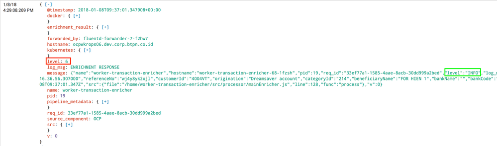

The "level" field is being automatically added by splunk, how to we ask splunk to extract log level from my json message ?

The reason splunk isn't automatically extracting this out is (probably) because the message field is JSON embedded in other JSON, as opposed to a sub-structure of the same JSON. I'm willing to bet the message field contains escaped quotes if you view the raw event. Here's a run-anywhere example of what I mean:
| makeresults | eval _raw="{\"message\": \"{\\\"level\\\": \\\"0\\\"}\"}" | spath
Gives a sample _raw of:
{"message": "{\"level\": \"0\"}"}
And a message value of:
{"level": "0"}
Which you could run spath against and get the results you want:
| makeresults | eval _raw="{\"message\": \"{\\\"level\\\": \\\"0\\\"}\"}" | spath | spath input=message
If the message field was part of the actual JSON structure (instead of JSON embedded in other JSON), _raw would look more like this:
{"message": {"level": "0"}}
Which would parse properly into message.level. The run-anywhere search to show this in action is:
| makeresults | eval _raw="{\"message\": {\"level\": \"0\"}}" | spath
So how do you make this "just work" without having to run a separate spath each time you search? I don't think there is a way. Even if you knew that you only cared about the message field and nothing else and you used SEDCMD to rewrite _raw when you index the data, it would still contain escaped quotes that are going to prevent JSON parsing from being successful.

Thanks for detailed explanation. But what bugs me is, the "req_id" field is also escaped within the message field, but somehow splunk has automatically extracted this out. Then why not the "level" ?
harsmarvania57
Ultra Champion
Are you able to see automatically extracted message.level field on left hand side? If yes then it will give you value INFO
kishoresanke
New Member
no, its not automatically extracted.
