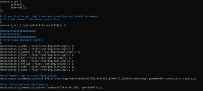

I have syslog-ng setup as follows:

Apart from all the questions @gcusello asked, remember that if you simply set your syslog server to forward the events to splunk server's 9997 port, it won't work. Splunk expects s2s communication on 9997, not plain syslog.
Question is whether you're getting anything received by your syslog-ng daemon at all. Does anything get written into the files in /var/log/remote?
Do you in fact get anything in on the 514 port?
Did you verify it in any way?

OK. For the rest of debugging @gcusello already pointed you in the right way. I'll just drop in a few words about this 9997 port.
Port 9997/TCP is used by S2S (splunk to splunk) communication. That is a protocol which is used to forward events from a source splunk machine (typically a forwarder) to a receiving splunk machine (might be an indexer but might be an intermediate forwarder). It is a proprietary protocol and is used only for connectivity between splunk components. So you can't just point your syslog server to send events to splunk server on 9997 and expect it to receive it properly.
As a side note - even though you can set up an input of tcp:// or udp:// type on your splunk forwarder to listen for raw syslog data sent from your sources, you typically don't want to do that. You'd rather use an intermediate syslog server (like you're doing here with syslog-ng writing to files which are then picked up by the UF).
